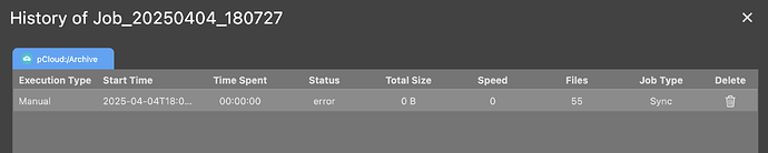

Just bought the app today, I’m on macOS. If I upload/sync smaller files, it works perfectly fine, but if I try to upload larger files, it “succeeds” but doesn’t actually do anything. In the Job History, the status reads “error”, but it’s not giving me any info at all as to what went wrong. How can I troubleshoot this? I should have tested large files before I bought the license ![]()
I got it figured out. I had to do a CLI transfer to figure out what was happening. Turns out I needed to set the Multi Thread Transfers to “1” and now I don’t get any errors.
Thank you very much for sharing your experience. We’re actively working to enhance error logging and plan to include improvements in future releases. Issues regarding multi-thread transfers constraints are generally handled by Rclone itself. However, if you have any additional configuration options you’d like to see within RcloneView, please feel free to suggest them anytime!
