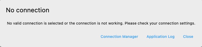

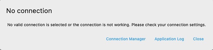

Getting "No Connection" msg, macOS, rcloneview v0.3.190
Startup rcloneview I get this
This may have started after latest macOS update Sequoia v15.3.

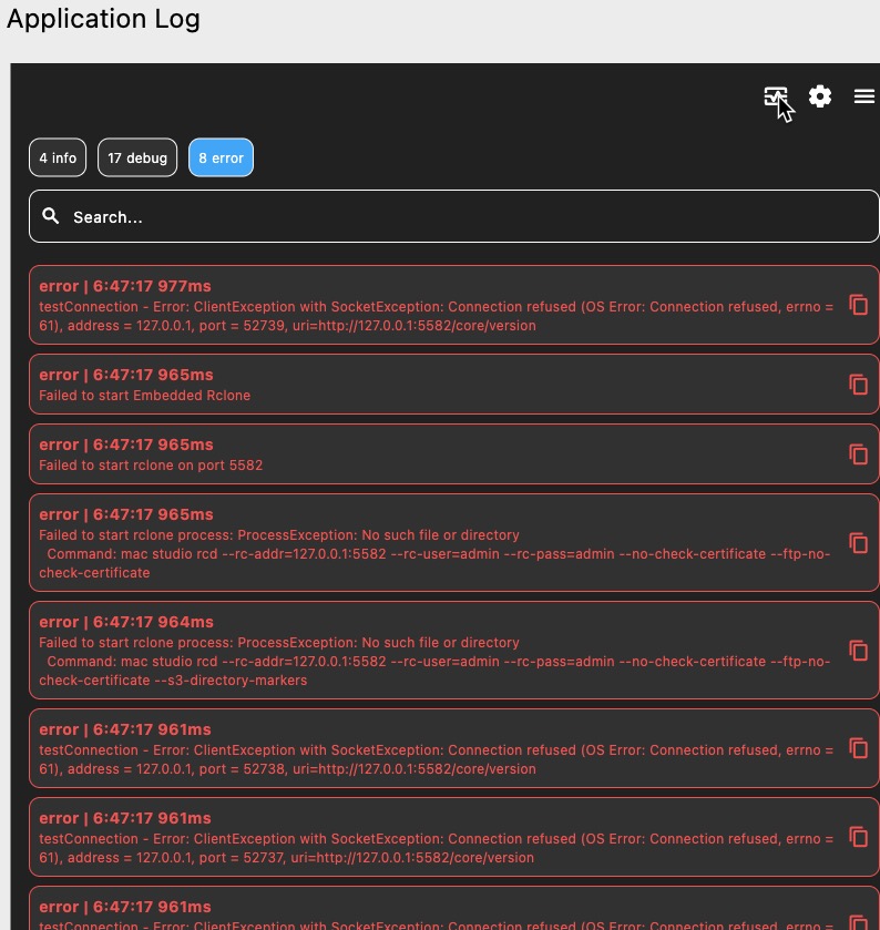

If I click on application log, I get

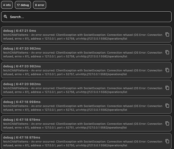

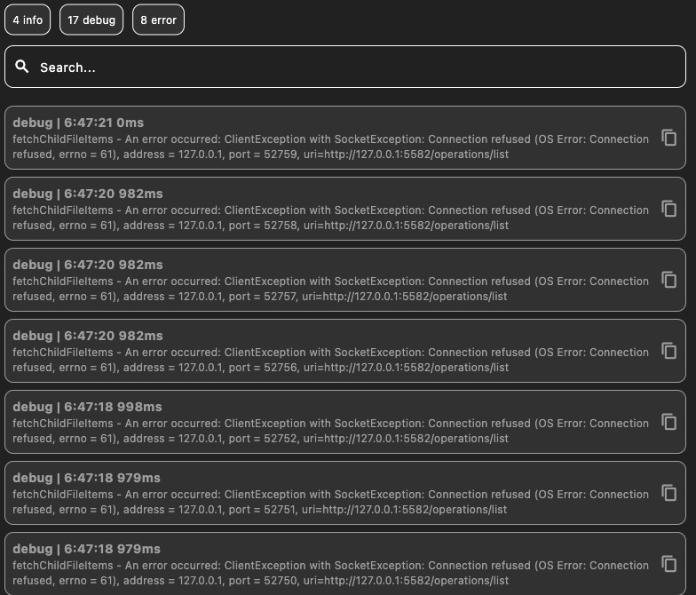

And if I click on the 8 error button I see this

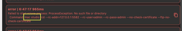

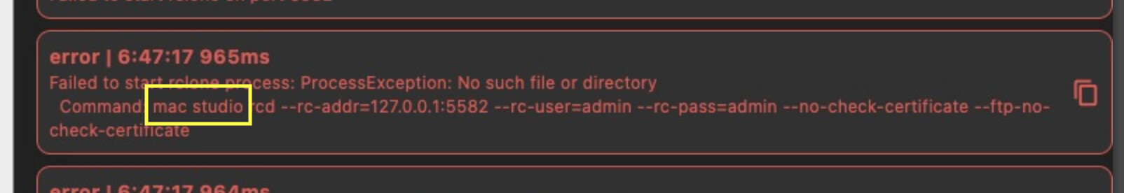

… which indicates it failed to start rclone which is odd since rclone works fine at the command line.
It is unusual that the log indicates “mac studio” was executed when running the embedded rclone command. We will investigate the potential causes of this discrepancy. Thank you for bringing this to our attention.
