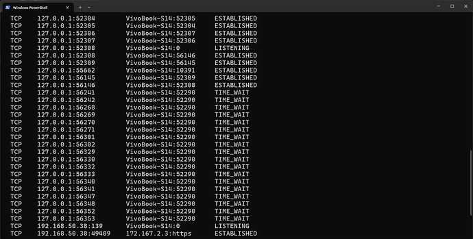

Hello,
I just signed up for the annual subscription, but I’m unable to connect to any cloud service.
Whatever I choose, I get the following error message:
Config failed to refresh token: failed to start auth webserver:listen tcp 127.0.0.1:53682 bind:address already in use
My machine is running Windows 11, and rclone, which is installed on a server on my LAN, appears to be connected correctly.
I’ve already confirmed that there are no other services listening on that port.
As you can see from the screenshot, there is nothing listening on port 53682.
Thank you,
Federico
First of all, apologies for the late reply and thank you for your patience.
The error you’re seeing —
Config failed to refresh token: failed to start auth webserver: listen tcp 127.0.0.1:53682 bind: address already in use
usually occurs when rclone tries to start its temporary local webserver during the authentication process. Even if nothing else appears to be listening on that port, Windows may sometimes reserve or block certain ephemeral ports, preventing rclone from binding correctly.
A couple of possible causes are:
  • Another background service briefly using the same port.
  • A firewall or antivirus program interfering with local loopback connections.
  • Multiple instances of rclone running simultaneously and trying to use the same port.
If the problem persists, I recommend posting the details (including your rclone version and logs) on the official community channels, where the rclone developers and advanced users can provide more targeted help:
Thank you again for reporting this, and for your support of RcloneView!
