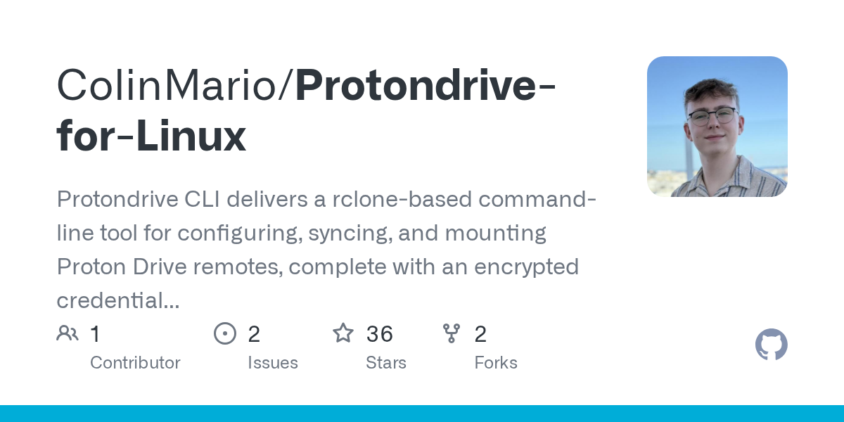

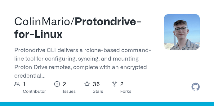

I do not know if you are trying to get Proton Drive to work with RcloneView (or anything that uses rclone remotes), but I just got mine working. I had to install Proton Drive for Linux from a GitHub project, then use it to make a remote. I then used the remote in RcloneView. Not very elegant, but it sure worked.
Hope this helps.
