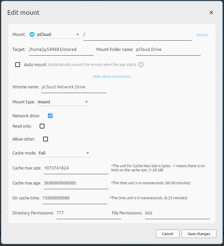

Team,
The following command failed to mounted the drive:
rclone mount pCloud: /home/jy549883/shared/pCloud.Drive --vfs-cache-mode full &
The following command successfully mounted the drive:
rclone mount pCloud:/ /home/jy549883/shared/pCloud.Drive --vfs-cache-mode full &
The difference between the two is the / after the remote name. I tested with Microsoft and Google without the / and they mounted just fine. This means that PcloneView needs to send the / for root for maximum compatibility.
The below is my configuration for the same thing in PcloneView, and it does not work. Note that I have another mount that I added a path and it works just fine.
Looks like a bug in the implementation in rclone not matching their documentation (or possibly in pCloud API), but easily compensated for in RcloneView by adding a default / for root access.

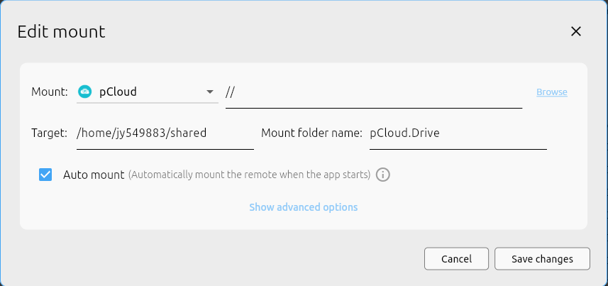

Team,
I just found a workaround. I just added a second / in the path. RcloneView must ignore the first slash when generating the remote path. By adding a second I worked around the issue.
Hope this helps someone else out there.
Thank you.
Jeff Y.
